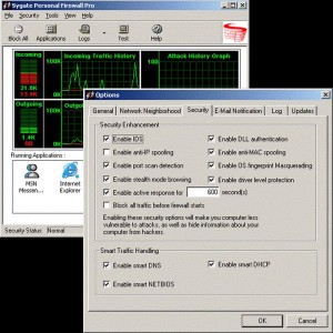

In addition to what Volker recommended, you might also want to consider a good software firewall. Try Sygate Personal Firewall (free) v5.6.

Well, what now? A good software firewall xor Sygate PFW?
