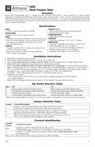

Hi Les Yeah, You can use this 6187523745&psc=1 to control This Since the internet relay doesn't have a momentary function, when you activa te the relay, a change in state trips the altronix relay which you set the timer to open a contact for a specified period of time to…

Hi Les
6187523745&psc=1
to control This
Since the internet relay doesn't have a momentary function, when you activa te the relay, a change in state trips the altronix relay which you set the timer to open a contact for a specified period of time to deactivate the ma g lock.
This might cause some confusion because sometime the internet relay will be in the off state and sometime it will be in the on state depending upon ho w the last user left it. But ----- you will have to determine how smart you r customer is to explain this to.

By the way Les, I've never done this before. It's just something I've thoug ht about and searched for. You can investigate it further. You may come up with a better idea

I can see how that might work one time but then again becomes a big question. I am sure I can jury rig something that would maybe do the job. But I seriously don't want to sell it and put my name on it.
What I was hoping is that there was a access control system that would have this kind of feature built in to a control app.
