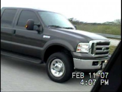

Google for Death Wobble or "Ford Death Wobble"
A
ABLE1
OH you mean like this??
