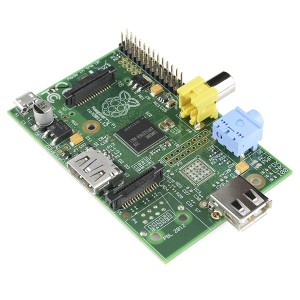

Has anyone used a Raspberry Pi ZeroW (or another Pi, plus a USB WiFi adapter) as a WiFi router?
As my existing WiFi router already connects to the internet using a USB mobile broadband modem, this might suit me more than most people, but there is an OpenWrt image for the Raspbery Pi:
My cause for looking down this path is that I want to set up a HTTPS to HTTP proxy on the router to serve all HTTPS connections to computers on my local network via unencrypted HTTP. This is because all the stupid websites forcing HTTPS (when it isn't needed) are making it difficult to keep all the software on my various computers compatible with the various and ever-changing encryption protocols required.
Currently I'm using a Netgear DGN2200 router, with OpenWrt installed. However for starters there insn't enough Flash storage space (8MB) to install all the software required to run the proxy, and beyond that it's doubtful that the 32MB RAM and 300MHz CPU would be able to do the job without slowing everything down.
The Raspberry Pi ZeroW with a 1GHz CPU and 512MB RAM should be fast enough, and as I'm only using WiFi and USB in the existing router, it should have all the hardware that I need built in. It would use less power as well.
The main thing that I'm worried about though is the WiFi range. I should be able to solder on a connector for an external antenna as described here:
However looking deeper it seems that my existing router may have more transmitting power (28.11dBm) than the Pi ZeroW (17.0dBm).
I don't really want a significant drop in my WiFi range, so would it be better to use a Pi Zero (non-W) and a USB WiFi adapter? In which case, which WiFi adapters should I look for to suit this application?

I get the impression that a Pi Zero W might not be the best choice. But that a regular Pi might be acceptable. Or some comparable SBC.
I don't know if or how it would effect the burnout that I was mentioning above.
I've got to say, I would take a look at some of the GL-iNet's small router / AP boards. I think they've got some close to regular Pi prices, run OpenWRT, have external antennas, and can be powered via Power over Ethernet.
Remember, Tx power is not all that it's cracked up to be. Sometimes you get better overall service with more lower power devices than fewer higher power devices.
I think I would use the USB WiFi adapter in favor of the WiFi adapter built into the Pi Zero.
