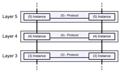

If routers are also switches, then they're offering both of these two functionalities:
A router works layer 3, a switch works layer 2 in the OSI reference model, see
That usually means, that the devices have some extra filtering functionality.

A router is doing packet forwarding in a special way in layer 3, while a switch is doing frame forwarding in layer 2, see:
No. A router at least has two network interfaces, because it's a multi-homed host.
