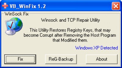

download a copy of winsockxpfix just in case. Rarely, the removal of NIS breaks the networking components in XP to the point where internet access is impossible. This little utility will fix it back up.
