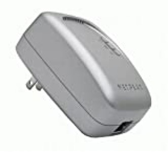

Another very simple option is to use Powerline Networking. You plug an adapter into the your router and then into the wall. As long as your garage has a socket is on the same leg of the transformer, you can plug in another adapter there for either ethernet or local wifi. Plug directly into the wall, no power strips.
Within the netgear line, go with the XE not the HD series - from what I've read, the HDs have electrical interference problems.
I've been buying the older Netgear ones (XE102) on ebay or Amazon fairly cheaply. They also have a version that gives wifi wherever you plug it in, but it gets quite hot and is reported to have a high failure rate. I have one that has not failed, but I try to keep it cool. Perhaps it's more reliable to use a pair of straight ethernet adapters with a cheap wireless router cabled to the remote one.

If the same feed/one meter, I've had great sucess with powerline networking, one unit in the house by the modem, and then a second unit with a wap/router whereever I want both wired and wireless.. Powerline networking under $140, spare wap/routers are under $50... Have the combo on power strips, and just plug em in wherever I want more coverage (garage, back yard, patio, gazebo, other end of the house where the Tivo's live/etc) if your answer is the outbuilding gets it's power from the house (or anyone lurking here wants em), I'd be glad to post the links for you....
Heck, why do two posts when one will do... here the link for the netgear powerline stuff
and the wap routers are from walmart Linksys wrt54g (for $49.17)
Fraid you are on your own for power strips, but you can usually find them for $2-$3 each.....

Not sure who wrote that, but instead of cat5 look into the powerline networking (ethernet bridge over powerlines, see the links for more info in a previous message in this thread).... You situation sounds like what it was meant for (you already have power from one building to another)......

Then get a pair of powerline networking adapters and play. Plug one in at the router and then another in the garage, just to see. Might still work across the meter if it's on the same leg from the transformer. If it works, then you have more options - ie; a third adapter that is an ap in the garage and the 2nd one with the desktop.
Finally, your plan to put an adapter/wireless router in at the end of the house by the garage sounds wise. Kill two birds and all that. As long as the materials between the garage and the desktop are not a significant barrier (ie. metal firedoors or double walls of concrete).
By the way, my comment about the powerstrip is the common spec they give. They often do work with powerstrips. Just try it straight first.
