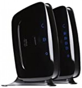

I notice that there's a newer model, a PLK300, which is:
much newer (2008, rather than 2006) twice as large (10"x9", rather than 4"x5") a little more expensive ($149, rather than $125) not as well reviewed at Amazon (3.5 stars from 5 customers, rather than 4 stars by 74 customers) presumably faster (300, rather than 200, although it's speed that I don't think I need).
Any thoughts on the new model?

Since Ethernet limits you to 100 Mbps, I'd go for the LINKSYS PLK200 PowerLine AV Ethernet Adapter Kit, $125 at Newegg with free shipping:
