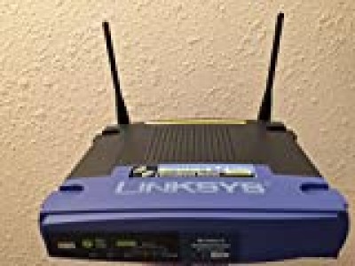

I have Linksys WRT54G Wireless-G Router like this:

Is there a pro and cos w.r.t distance bewteen wirelses PCI card and a USB wirless adapter? The PC that I need to make wirless capable will be downstairs in opposite direction from the wrireless router upsatirs.
Should I get linksys brand since my wireless router is Linksys?
