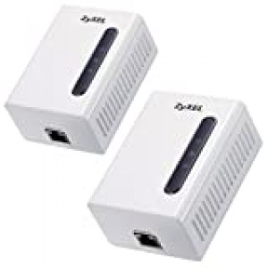

Get a set of Powerline Networking wall-plug units and plug one into the router and one downstairs into the netgear's LAN port. Reset the Netgear router and it may work just fine like that. Make sure you have security to the admin access and wireless on both routers.
Powerline adapters cost about $100 new for a pair - or less for used. They don't always work, depends on the device and you home wiring. The Netgear 103 84 Mbps are known to work well. There are others that I don't have any experience with but may also be good.
