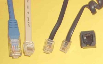

Question on phone cord connectors open original image
If the connector for the phone line coming from the wall is an RJ-11, what connector is used for the coiled cord connecting the handset to the telephone? It seems a little smaller. Any help is appreciated...

Wikipedia says that it's commonly referred to as an RJ9, RJ10, or RJ22, but it also says that those names are incorrect. (I think the deal is that it's only officially an RJ-series connector if it's part of the standardized telephone system, and the handset connectors are completely up to the whim of the manufacturer, even though there is a de facto standard.)

The most correct name for the handset connector is a 4p4c modular plug/jack.
Just like a phone line connector is a 6p2c modular jack (or 6p4c sometimes).
And an Ethernet jack is an 8p8c modular jack.
ie. x position, y connector.

No. How can you have eight positions, and ten contacts? A 'position' is a place for one contact.
No, it would be 10p10c modular connectors.
They can be a touch wider than 8p8c jacks as well, but not enough to account for the "extra" 2 connector pins.
the plug is the same width as that used for twisted pair ethernet, what is commonly called "RJ45" or 8P8C, but it has 10 contacts.

The width of the housing has nothing to do with the designation. It could be three feet wide, and still only have ten postions.
