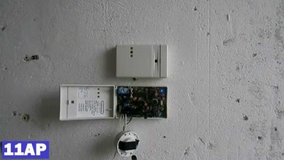

Well, to get back to the original topic, I got a 5620 Shatterpoint sensor i nstalled. The shock sensitivity is quite poor. I have to wack the frame wit hin a few inches of the sensor, otherwise it doesn't respond to the shock. Not sure if I got somehow a defective unit off e-bay, but it appeared new.
The shock sensor is a little piezo sounder, which seems fine. There is no s ensitivity adjustment, as far I can tell it goes into a PIC microprocessor without any amplification.
If anyone has these units, how sensitive do they supposed to be to shock?

Well, to get back to the original topic, I got a 5620 Shatterpoint sensor installed. The shock sensitivity is quite poor. I have to wack the frame within a few inches of the sensor, otherwise it doesn't respond to the shock. Not sure if I got somehow a defective unit off e-bay, but it appeared new.
The shock sensor is a little piezo sounder, which seems fine. There is no sensitivity adjustment, as far I can tell it goes into a PIC microprocessor without any amplification.
Many of the piezo style shock sensors are very dependent on the type of mounting use to secure them to the frame / glass... Some in the past have required them to be glued directly to the surface.. I've seen some mounted with double stick tape , which defeats the design of the sensor.. (ie... no alarm trigger) Also have seen some mounted on wired glass, which is also a no-no...

Of course I followed the installation manual, used screws to attach it to t he wooden frame. My actual windows are vinyl, which may be a problem in its elf, its not very rigid. When these sensors were developed, vinyl windows p robably were not as common as they are now. But like I said, even if I whac k on the same piece of wood the sensor is attached to, it only works within a few inches.

installed. The shock sensitivity is quite poor. I have to wack the frame w ithin a few inches of the sensor, otherwise it doesn't respond to the shock . Not sure if I got somehow a defective unit off e-bay, but it appeared new .
sensitivity adjustment, as far I can tell it goes into a PIC microprocesso r without any amplification.
I'm not familiar with the particular unit you have but from your above desc ription it seems as if you are expecting the unit to respond to the shock . ... alone.
Typically a glass break detector should be mounted firmly to a wall or ceil ing at a distance no further than the instructions recommend. I always inst all them well within the recommended distance. Installed in direct line of sight of the glass. Not near air ducts. Rooms that are "soft" are going to limit the sensitivity. Rooms that are hard are going to enhance sensitivity . Windows with blinds, curtains or drapes will be less likely to trip the s ensor. When the shock occurs the unit will not go into alarm. When the shoc k is followed by the sound of breaking glass, it should trip.
Testing them is somewhat an act of faith. Manufacturers will have a recomme nded audio tester available to purchase which you are supposed to believe w ill test the unit appropriately as an actual breaking of the window. I use the tester but hardly believe it is a true test. Years ago, when audio glas s break detectors were new to the industry, one manufacturer (I forget who) would send a rock with the detector tagged with a note "Glass break tester "
You might want to break up some glass, put the pieces in a larger sealed gl ass jar and then hit the wall and shake the glass jar. I used to do that be fore the manufacturers came out with testers. YMMV. As the sensors became m ore advanced that method didn't work as well.

It has a test mode where it is supposed to give two long LED flashes just from shock. That is what I am testing, as the manual says.

Ahhh! As I said, I'm not familiar with that unit but from what you are observing I'd say the unit would be faulty.

I got an op-amp amplifier on E-bay for $1 and wired it up to amplify the pi ezo buzzer used as shock sensor by a factor of 100. This works pretty well, the shock sensitivity is now adequate and the false alarm immunity is quit e good. So the idea of the 5620 is good, they just tried to save a buck by skipping the input amplifier.
