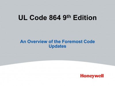

This is Honeywell's assessment of UL864 9th Edition. I can only find a reference to the requirement of having 2 means of communication.
