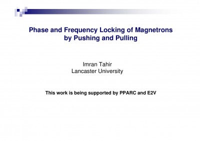

Well, let's do a bit of math. Let's pretend his antenna has a VSWR of about 1.5:1 which will reflect about 5% of the power at the antenna. The circulator dummy load has to absorb this reflected power. 800 watts coming from the magnetron yields 40 watts in the dummy load. 40 watts of dissipation will require a rather large dummy load. In addition, the circulator usually burns about 1dB of loss, so it will need to dissipate about 80 watts itself. I could probably build a hybrid ring circulator that would handle that, but not a ferrite circulator. How one would use a circulator to modulate a magnetron is beyond my imagination. However, there are articles on phase locking magentrons for use in a particle accellerator, so I guess it can be done by phase locking it to an 802.11 source.
