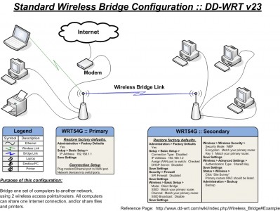

What kind of router do you use for the bridge? That's what I want to do with mine. I got a nice diagram
but I don't know how to configure the Actiontec that way.

I sent this to Actiontec tech support: ,-- | Hi, I have two MI424-WRs (one from Verizon, one from eBay), and I wish | to EITHER (1) set up a wireless bridge for the Xbox; or (2) put the | Xbox on its own subnet, which is connected to the rest of the LAN | wirelessly. | This need to be done in such a manner that wireless devices can still | connect to router #1. Is this possible? I found a diagram but my IP | knowledge is inadequate to apply it to this case. '--
They responded: ,-- | Negative. The MI424 used by Verizon lacks programming for bridging the | connection. Simply use ONE MI424. Once your XBOX is connected, simply | use the pre-programmed entry in the port forwarding list of protocols | for XBOX to open the ports to the XBOX consoles IP Address or name. | (XBOX consoles do not have names like a computer and show as either | new or unknown host in the device list) '--
So that router with the standard firmware seems to be out. DD-WRT is being ported to the router last I heard, so who knows when that'll be ready for public consumption. The RALink wireless card (inside the router) is a miniPCI card, so I'd need to replace it with an Atheros-based card. I'm thinking it would be worth it to get a dedicated wireless bridge device.
