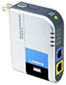

I have a Linksys WTR54GS travel router. I am trying to use it to share a wireless connection to three other machines also using 802.11g. For the most part it works, but if one of the shared machines starts a filetransfer or something that takes alot of bandwidth (youtube, skype) the internet connection quits. We still have wireless connectivity so I don't tink it is a channel issue. I tried setting the machine's MTU to 1,200 with no difference. Remember, I am trying to share a wireless connection, I do not have access to an ethernet port. The connection craps out when I'm using alot of bandwidth - file transfers, Youtube - but normal browsing seems to be OK. The ISP is not throttling the connection since I can transfer huge files without a problem when I remove the router. It is not interference since I can sit in the same room without the router and still download from the source AP. Somebody in another group said I should change my station preamble to long - but I can't find the setting to do that.

Yeah, the WTR is from the days when Linksys was "questionable" and the fact I have one that only partially works seems to reinforce that fact. For casual browsing it works fine. But during a huge file transfer the internet connection drops. I sent a message to the seller to see if I can exchange it.
Hi, I guess f/w is latest?
Yes, it is. They stopped updating it a while back though. I'll post a video showing what its doing. I just have to figure out a way to graph the internet speed and still see the unit's flashing LEDs.
