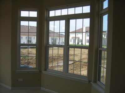

I am having an ADT system installed (ADT direct, not a reseller) and will be using their rebranded Ademco wireless window sensors on 18 windows on my main level. The windows are new, warrantied, and white vinyl which is why I am going wireless.
The problem is related to my window blinds. My two inch blinds (which I always leave in the full down position but swivel open and close daily) leave less than a 1/2 inch between the back of the blinds when open and the window surface. This appears to be less than the depth of the sensor if we place it on the vertical side of the lower window (they are single hung windows that have the bottom window slide up and down). This would push the blinds out a slight bit (they would be touching the sensor) and that seems unacceptable. The same issue exists if I mount the sensor to the bottom sill as the blinds would rest on the sensor which would look bad and perhaps cause the same issue. I can't mount the sensors horizontally on the top corners of the bottom window (with the magnet in the track) because the latches for the window to rotate into the house are located there...
The only place left I can think of? DEAD CENTER of the horizontal top of the bottom window with the magnet on the glass surface of the upper non-moving window. Do you think this will be horribly ugly? The sensor matches the color of the white vinyl windows and the blinds should help concel the boxes but I am really concerned about the look of the whole deal.
Any suggestions on other mounting options.

NOW IF ANYONE IS WILLING TO HELP ME i have a photo of what all the windows in general look like (before the blinds were placed.)

I have two suggestions for the windows. First, I don't know if you're aware that there is a separate contact point inside the 5816 transmitter that will allow an external window contact to be used. So in x-mitter can be mounted below the sill, or somewhere else out or the way and just run a short jumper to mini-mag contacts that will actually go on the windows. Second, if the internal contact is to be used and you lack a small amount of clearance for the blinds there is a low profile transmitter available, PN 5816MN.

There are 1/4" x 1/4" self-stick magnetic window contacts which your installer may want to try. One of the most popular is called a
1035. It's made by GE Security (formerly Sentrol). Since you're having the system professionally installed, ask the salesman if he will try those or something similar. If they flat refuse, you can order them online and swap them with the ones the alarm company puts in. They're not expensive.

If you use wireless transmitters on your windows, and the blinds are in the way, the transmitters will either be mounted on the the window frame as you mentioned, or outside the blinds making them visible. What do you expect the installers to do? Do a little magic trick just for you? Doug already gave you the best solution. Stop whining, will ya? js
One thing you could do IF you plan on using curtain as well is, install a very small surface mount contact and wire it to the transmitter, then mount the transmitter jsut next to, or on the window trim and hide it with curtains.
Ask for the mini transmitters, and mount them on the top of the window = frame, or mount the txm to the sill infront of the window, and simply stop = your blinds on top of the sensor.

Here's how we do it on tough houses like that...and we charge more for it.
We cut a single gang hole in the wall underneath the the window at outlet height where we will put the transmitter, then we drill down through the window sill and run the contact down to the transmitter, the blank plate it. Time consuming but looks great.
