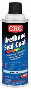

Hi Les,
I've used this in the past
Granted it was a long time ago, but I never had to go back and change the k eypad so it worked Ok. Viking Telecom Solutions has an option on their outdoor products to weather proof them but I don't know if they have a keypad or not. Besides I think they all they do is just dip their PCB's in some kind of gook and charge yo u another $100.00
I'm thinking that just dipping (or painting) the PCB in some polyurethane w ould do the same thing and last at least 5 or ten years.
Hey Jim,
Now that is some serious STUFF!! Never heard of that before.
I will have to source that at my local distributor. Grainger closed their local store a few years ago. I liked going there to pickup a specific thing or two. Always good to walk the isles to get ideas.
Thanks for the tip. Much appreciated.
Les

Just Google CRC Urethane Seal Coat and I'm sure you can find it and other b rands of PCB seal coatings on line.

My local distributor carries CRC products. I just need to call and find if in stock or needs to order. Easy to do either way.
