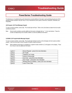

I don't use DSC but this guide was found on their website..

General System Tamper means one of your external modules has a tamper
Light [4] - General System Tamper. This trouble will be indicated if a Tamp er Zone violation on any module is detected.
