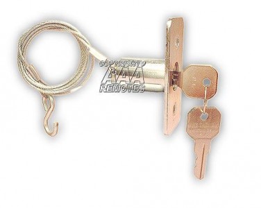

Or if there is no other door, then this $12 no-fail device works:
That would definitely enable access, come hell or high water. Two doors with two remotes would also do it but when the power fails your link would be the best, barring a second entrance / man-door.
