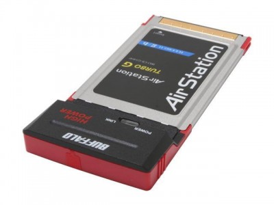

WLI-CB-G54HP
About $50:
The card has an external antenna connector, which might be handy. I have two of these and they work well enough. The range is nothing spectacular, but if you want PCMCIA, it's good enough. For more range, look into external antennas, or wireless devices with an integral directional antenna.

There's a rubber plug at the end of the Buffalo card. Underneath is an "Orinoco" or "MC Card" connector. You buy a "pigtail" coax cable that adapts this connector to whatever external directional antenna you find useful.
Erica Eshoo hath wroth:
MC Card to RP-SMA pigtail for $8.

If she can still find one of these, this would be the best choice for a weak signal. However Buffalo cannot sell into the U.S. any more, so it'd have to be existing stock from a retailer. NewEgg still has some, "
