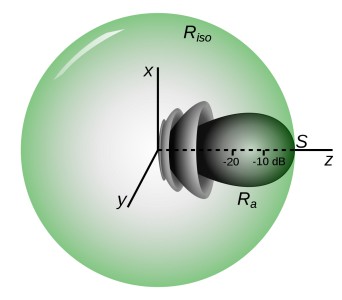

Unlicensed operation of Wifi devices, works in terms of this measure.
When you slap a parabolic antenna on the Wifi device, it squirts the power out into a "beam". The power is more concentrated in the center of the beam. The Wifi regulations use the power in the center of the beam, to set the limit. The Wifi normally comes with a low gain (omnidirectional) antenna, so it doesn't beam very much. The transmitter can use more power at its level, because the antenna has no large gain to speak of.
When you use the parabolic antenna, now the signal is a hundred times stronger in the center of the beam. Without too much effort, you can exceed the unlicensed limits. Now, end users never worry about this, and in the real world, it takes a "complaint" to a radio regulating body, to have someone kick down your door. No radio amateur would expect to pass a signal at the same frequency as Wifi, so the only person who might care about your excessive power, would be another Wifi user who cannot use their gear. So for the most part, "you're safe".
If the router had a dish like that, and the laptop had one, you might get some signal through the wall. But a better prospect, would be pointing both antennas at the building across the street, and using it as a reflector.
The higher the gain of an antenna like that, the narrower the beamwidth. I built my own antenna for OTA digital TV reception, and it had a beamwidth of 15 degrees or so. And it was a bit hard to "aim" at the TV transmitter and get the signal level maximized. If you use two antennas, and try to aim them at one another, it can be tricky to complete the alignment process. You really want a signal strength meter that works in real time, and gives good feedback as you wave the things around.
