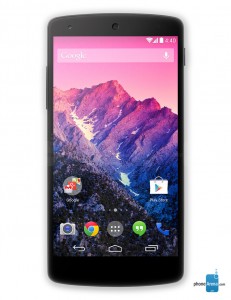

Kid is traveling in Europe, -90dB, what's the sensitivity Nexus 5 open original image
My daughter is traveling in Europe with the Google Nexus 5 and is getting a WiFi signal strength of -90dB using InSSIDer.
She can't connect to the WiFi at that signal strength.
I looked up the receiver sensitivity but can't find the spec:
Does anyone have the Nexus 5 receiver sensitivity spec?
