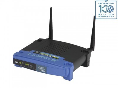

I own a Netgear Wireless Router WGT624v2. I believe its quality leaves much to be desired. Can anyone help with the recommendation of a

If you will get WRT54G, avoid version 5. I heard there's a lot of problem in this version. Get version 4 or if you can find 3 or 2 much the better.

Great! Im glad I read this after I buy my router. :-( I just bought a v5 last week and sure enough after a day had to take it back because it wouldnt let anything out onto the internet. I ran the troubleshooting page and at first it showed that it was renewing its dhcp lease without trouble and i was able to ping internet sites from the computer that was connected directly by cable but not from my wireless. After a few hours it wouldnt even let anything out at all. I took it back yesterday and traded it for a new one and so far the new one is working fine but I hope it doesnt start dying on me after reading this. :( Does anyone have any other suggestions for a good decent router? I had problems with a Belkin recently also and had to take it back for similar reasons.

There's tons of stuff on hacking the WRT54G, but there _isn't_ tons of stuff about the V5. I haven't heard that the V5 has any specific _problems_, but it doesn't run Linux and doesn't have the same hardware as the other versions.
Well, not even an hour after posting this my internet connection went down. Not only for the wireless laptop but for my pc as well. It was still connected to comcast as i was able to run diagnostics from the router itself pinging ip addresses but it wouldnt let none of my computers out (resolving problem)? Well, after a reset it worked but then again not an hour later it did it again. I dont know how to tie this 100% to that router, but I hooked my netgear back up and it hasnt dropped connection since. I run debian linux on my home pc and windows xp on my laptop and the networking is allot easier to deal with on the pc. Im pretty much done with that router. Im not going to reset that MFer every hour to stay connected to the internet. Thats just flat B.S. Anyway, can you tell im a bit miffed????
Back to the p.o.s. 30$ netgear that has never dropped connection once. Too bad it doesnt have a very good range.

I've had 2 customer buy WRT54G v5 boxes. I had to upgrade to 1.00.6 to get them to work even halfway right. See the release notes at: |
what was fixed. As far as I can tell from 2 units and from 2 others where customers upgraded it by themselves, the v5 boxes still have problems, even with 1.00.6. I've seen:
- erratic PPPoE login failures to SBC.
- hangs when using BitTorrent (despite the alleged fix).
- garbled VoIP which was not present when using a different router. (It's not the QoS settings).
- hangs on wireless to wireless large file transfers.
- hangs on streaming UDP after about 10 minutes.
- failure to deliver a DHCP address an old Mac G3.
In 2 cases, the problems went away when I returned the router and replaced it with a different model (WGR614v5, WRT54GC). No clue what's happening with the other two.
It's not a great sample and there are some inconsistencies. All 4 routers did NOT have all the problems listed.
