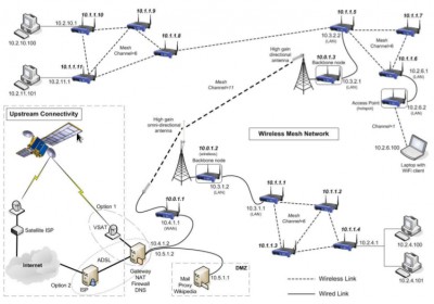

I'm just playing around with setting up a "mesh" wifi access for my entire neighborhood, and would like to discuss theory if possible.
Am I right in that using a router as an AP only (or bridge) would cut the bandwidth in half?
And, for experiments sake, I'd like to get an idea of what kind of hardware to buy to allow access for, say, 100 homes, in a 6 block area.
I know I'd need to convert the AP for outdoor use (I'd like to play with cheaper consumer stuff), which I can do using an oudoor box and power over the cat5, right? Although I'd probably design a conduit to carry the signal and 12V seperately for easier maintenance. Any idea the wattage necessary? I'm thinking of using PSU's from scrap computers.
Then, how about the repeaters? I need the same brand usually, correct?
I know about the LOS issues, and plan on doing all roof mounts, and USB client adapters. Also, any idea of the bandwidth necessary and how to limit it to each client? (100 users, typical home use).

Why use a mesh? The only real benifit to a mesh network is the cost savings on the wired backhaul to the ISP. Since you're probably only going to have one or two backhauls, there's not much savings. Instead, you get the deal with store and forward packet repeaters, that eat airtime, mutual interference problems, bandwidth bottlenecks, complex routing algorithms, and performance issues. More specifically, you only use mesh when you absolutely must use mesh.
Light reading:
Reality. Be sure to read this one carefully, especially the part where there's typically 50% or less probability of delivering a packet intact, and the reliability even at 1Mbit/sec.
The commercial version of Roofnet:
Not quite. One hop will cut the *MAXIMUM* thruput in half. Let's pretend that you're very lucky and get a 36Mbit/sec association (that's a wireless connection). Maximum thruput is about half or
18Mbits/sec for TCP (assuming no interference, etc). However, if you shove that through a mesh network or store-n-forward repeater, it gets cut in half again to perhaps 9Mbits/sec. I say perhaps because it's usually more than half if there are a number of mesh nodes nearby. If you add a 2nd hop, it gets cut in half again or 4.5Mbits/sec *MAXIMUM* TCP thruput.
What you need is a good overdose of reality. Setup a mesh network in a closed room, where everyone can hear everyone else. A dedicated repeater or WDS bridge will suffice. Now, try to measure performance from end to end using IPerf (instructions on request or Google this newsgroup for my posting on IPerf). If you turn off the repeaters, you should get something near the maximum theoretical performance. Turn on the repeaters, and watch the thruput drop radically along with a corresponding increase in retransmissions and errors. Try it.
Ummm... 100 customers? Every time it goes down, you want 100 phone calls? Have you perhaps been snorting, injesting, or smoking controlled substances? Never mind the technology. Do you think you can handle the complaints and service calls? Whatcha gonna do when some clueless user comes home with a virus or worm and eats all your bandwidth? How about the not so trivial problem that customers will tend to call you first, before calling their computer guru (who charges money), simply because you're cheaper? Do your really need this headache?
Anyway, the loading is easy: 100 light email and web users 10 business users 1 file sharing user It doesn't matter how many access points or backhauls. One user can hog the whole system unless you have monitoring and traffic management in place.
Ummmm.... How big is a "block" in feet or meters? Is that a city block or country block? Tall apartments of single family suburbia?
Right. It's called PoE (power over ethernet) or 802.3af. There are vendors that will sell you the complete package, or just the pieces. For example:
The delivered power is limited by the resistance of the power wiring. That's why PoE is normally done at 48VDC, so that the effects of the wire resistance is minimal. Junk power supplies are only going to supply 12VDC, make a bunch of noise, probably smoke the cable if you short it, and are not terribly reliable. Look into real PoE adapters.
Repeaters are not very well defined in the IEEE 802.11 specs. The result is substantial incompatibility among vendors and versions. That's one nightmare I suggest you avoid. Repeaters are also a basic component of mesh networks, which I previously suggested are a bad idea.
Keep planning. You'll find that USB is limited to 16ft maximum cable. You can get amplifiers that will go farther, but then you have to supply power at the destination end. Use ethernet and PoE instead.
Look at the real bandwidth managers:
and see what you might need. Also note that it's not enough to simply configure a bandwidth manager and let the system free run. You gotta monitor the traffic to look for abuse, changes, hackers, idiots, and failures. You'll need to know the performance of each user and which one's are hogging the system. Check out various traffic monitors.
In case it's not obvious, you're going to need EVERYTHING that a typical wire line ISP uses, with the added enjoyment of an unreliable means of delivery. If you want to do this for free, that only eliminates the billing system. Everything else still has to be there.

Yep. Overly simplified, you have several problems:
You're building a WISP (wireless internet service provider) but are not very aware of how much work that really involves.
Mesh networks can be made to work and certainly have their place. Servicing non-paying neighbors is not my idea of one of those. Others (such as Earthlink, Meraki, and various manufacturers will disagree).
Delivering reliability and quality service via Wi-Fi is a dubious proposition mostly due to self-interference.
Mesh systems do not scale very well. The problem is that you discover this only AFTER you spend considerable money. Anything can be made to work on a small scale.
Also, I can tell you did NOT read the MIT Roofnet article or you would have some questions regarding thruput and reliability limits.
Well, you could just join Meraki and try their system. It's not that expensive and certainly cheaper than a do it thyself system. If mesh is what you want, you'll certainly get a clue on how it works very quickly. If that's too much trouble, go unto the Google (free) Wi-Fi complaint and help message board, and see what manner of problems a real mesh system can generate. Remember, as system operator, owner, and chief technologist, *YOU* get to answer these type of questions.
As for what I had in mind, I'll answer your questions after you answer mine. For example, how big is 6 blocks in feet, meters, cubits, or furlongs? That's not intended to irritate you. It's because wireless networks are designed to operate in specific environments and topologies. What's suitable for a small coffee shop hot spot, is not suitable for "illuminating" an office building or apartment complex. Give me some numbers and I'll gladly spend your money for you.
Dream on. Sounds like you're thinking of an omnidirectional antenna. Yeah, that might work for starters, but has some rather severe limitations, especially when it comes to minimizing interference. I'm a big fan of "sector antenna", where you have multiple access points and multiple 90 or 120 degree sectors per access point. However, I can't tell if this is suitable for whatever you're doing.
Yep. Learn By Destroying (tm). Nothing like repeating their mistakes on a small scale. I recall the definition of insanity was doing the same thing multiple times and expecting different results. As I mentioned before, you're problems are NOT going to be technical. They're going to be administrative and system management. Simply identifying the cause of problems, separating them between user and system problems, and doing something about it at 4AM, is going to be a major challenge. That's why I wanted you to start with a small scale system. You'll get all the experience with irate customers immediately and will not have to wait until the system grows to get the experience. Also no need for a mesh with a small system. I have a neighborhood wireless and wired LAN that I run. I often regret doing it simply because of the weird problems that tend to appear at odd times. For what it's worth, I tried to use old 802.11b junk radios and am now replacing them with much better and more reliable
