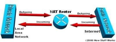

What you currently have is called "double NAT". It's not for redundancy, reliability, or anything useful. It's just a side effect of having two boxes that are both doing NAT. You only need one to do NAT in this case.

RFC 2663 "IP Network Address Translator (NAT) Terminology and Considerations"
There are two variations to traditional NAT, namely Basic NAT and NAPT (Network Address Port Translation). These are discussed in the following sub-sections.

Thanks. I was used to Cisco calling that PAT (port address translation) or "NAT overloading" in IOS.
