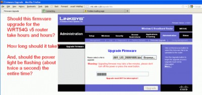

Worried that the intruder put software on the router, I tried to upgrade the firmware. After about 2 hours of watching the little bars go over nd over across the screen, I unplugged it all.
Now the power light is flashing about twice a second, and I can no longer log into the router, despite a bazillion reboots and resets.
Two questions: a) How long should it take for a firmware upgrade? b) Should the power light be steady or flashing on the WRT54G v5?

But, now it's even worse. With the router reset to defaults, I had no problem logging in. I decided to update the firmware, just in case, using the file FW_WRT54Gv5v6_1.02.8.001_US_20091005.bin downloaded from the Linksys site for the v5 that I have.
This process went on for hours ... from about 11:00 to about 1:30 when I finally gave up and pulled the plug. (BTW, how long 'should' a firmware upgrade take anyway?).
Here's a picture of what showed for hours (the lines were moving and repeating themselves over and over and over again):
Then, after rebooting and resetting a few times, here's what then showed up:
Now I can't get anything to work on the Linksys router. No connection.
Two questions: Q1: How long should it take for firmware to install itself? (I gave up after almost 3 hours) Q2: Should the power light be constantly blinking or should it be steady? (Mine is blinking)

The update should take about 60 seconds plus reboot time. Something went wrong. Hopefully, you didn't try to do the upgrade via a wireless connection. That's usually a guaranteed disaster.
Checking the web site, you have the correct version:
No checksum, so I have no way to verify if it was correctly downloaded. You might want to try another download just to be sure.
It's bricked, but probably not fatal.
About 60 seconds plus a reboot.
Nope. That means there's a checksum error in the firmware.

Whew! The version 5 Linksys WRT54G is back in business!
After unplugging everything but power, I did the 30/30/30 procedure which was to hold the button for the entire 90 seconds - the first 30 while the unit is powered - the second 30 while the power cord is removed - and the third 30 seconds while the power is back on. Then I let go of the reset button.
Following Jeff's hint, I again downloaded the same file I had downloaded before - overwriting the old file for my WRT54G version 5 router:
I then pinged 192.168.1.1 and this worked (much to my surprise) even though the power light was still blinking and no other light was on (not even the "CiscoSystems" orange light).
I opened up Firefox and went to 192.168.1.1 and was surprised to see: Management Mode Firmware Upgrade
So, I hit the "Browse" button and then the "Apply" button and ... lo and behold, after about 2 minutes and much flashing of the LAN light on the router, the web page changed to "Upgrade Success".
I was worried because the power light still blinked for about two minutes or so, but then it settled down, and now is a solid green!
I was able to log into the router at 192.168.1.1 and immediately noticed I was at version 1.02.8 (plus the blue color changed in tone).

Here is a pictorial look at what I did AFTER my router was bricked:
  1. I ran the 30/30/30 procedure which left the power light blinking but allowed me to ping the router. This was a good sign.
  2. In a browser, I went to 192.168.1.1 and was happy to see the Management Mode Firmware Upgrade page. I downloaded a 'new' Firmware upgrade and browsed to it and hit the "apply" button.
  3. After only a couple of minutes, I saw the Upgrade Success notification in the browser:
  4. Logging into 192.168.1.1, I immediately noticed a different shade of blue and that the firmware had been updated to version 1.02.8.
