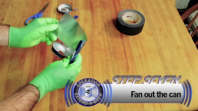

Kim komando put out a video showing how to cut beer can to become a reflector for a Wifi router.
So, since my Linksys WRT 54G has two antennas, Why two, and which one do I use, or do I need two reflectors?

The one labeled "main". Unfortunately, it varies with hardware version. Which hardware version do you have? See serial number label. The "main" antenna is usually the one with the shortest RF path between the antenna connector and the diversity switch. See photos:
If you have alternative firmware installed, you can set it to use just one antenna.
The reason for two antennas is for diversity reception. Switching between two antennas in receive does a good job of eliminating frequency selective fading.

WRT54G V 5 Looks like the right side antenna looking from the front. I might try something for my internet radio. It's two walls away and on occasion has problems. I seem to recall a screen that said 70% signal. I don't have a beer can, I'll try Dr. Pepper. Btw, all those versions, have they got it right yet? Actually, I'm very happy with it, I bought it used. 7 or 8 yrs ago for $25, most I've had to to do is reset the power once in a while. Mikek
I have seen a reflector on each. If you had ddwrt you could select. I'm sure some kind of diversity is being used to optimize something. The beer can is sharp. I built the cardboard- aluminum foil type. Safer. Are your antennas removable, and how much gain do they have.

70% signal should be a quite solid connection. Howver, you can have 100% signal, and it still won't work if you have an interference problem. Look at the SNR (signal to noise ratio) or signal quality indication for a clue.
Go the hardware store and get some aluminum roofing flashing and do it the right way.
