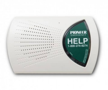

Hi all,
I'm looking for some general information & advice, not solicitations.
I want to get a medical alert device/service for an elderly relative who lives far from me. There is no need for burgular alarms or other types of security.
I want to pay for a service rather than trust something that calls the neighbors. I want the service to bill me not my relative.
Will the hardware just be an auto-dialer, similar to the DIY medical alerts, but programmed for the service? If so, could/should I install it myself?
Should I be looking for a local or national service?
How do I pick a good service?
What other questions should I have?
Thanks,
-troy
