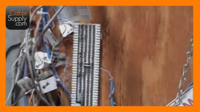

Can anyone recommend a good unit for locating buried wires? Seven years ago during construction I left wires in walls for possible use: door switches and motion detector. Condo has changed owners several times; current one wants to get burglar alarm working. NX8 has been monitoring smoke detectors.

Here is a video on how to use the toner & probe:
