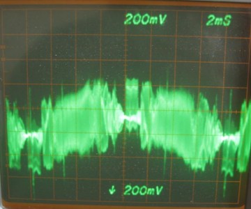

I have a 120V 4W LED produced by Lumoform that produces more noise than any CFL I have tested. Here is a photo of the X10 signal just fitting between the noise bursts:
The X10 signal is at mid-screen and near both sides of the trace. It fits in the little gap after each zero crossing before the switching supply in the LED starts up. The XTB-IIR can actually recover that X10 signal.
Jeff
