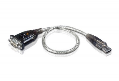

Anyway, thanks to all for your extremely helpful contributions. My solution was to actually take David's advice and go out and buy a USB-Serial converter.
I ended up getting the Aten UC-232A
which works perfectly using the CONFIG_USB_SERIAL_PL2303 module in Linux.
