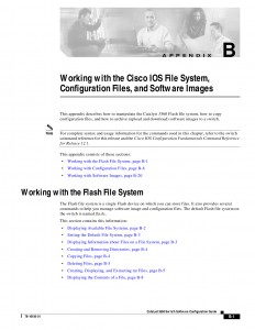

do a show file systems, and paste the output. I'm going off of this link, still trying to figure out how to change the permissions presuming you are showing nvram as RO and not RW. Let me know.
Oops, here is the link:
