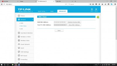

Here is the screenshot of the router setup that is currently working:
I don't want to touch anything.
I just want to understand why/which/what mac address cloning is necessary to get it working once the power goes down.
The now-cloned MAC address of C4:E9:84:3D:9E:8C is a TP-Link OIC. It's not the mac address of the Costco Arris/Motorola modem.

Here is the router web page that is currently working:
Router is brand new and up to date. It's not actually "my" setup. It's my kid's setup at college.
