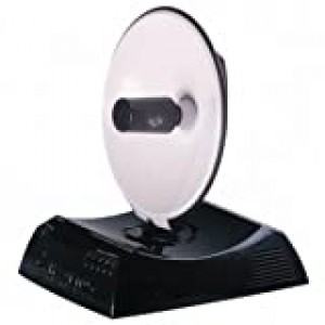

Is this what you're looking for? LZ
OK, you guys said the antenna concentrating the energy to a narrow direction. But how does the omni wifi antenna work? why it has a gain?
I connect my linksys 802.11g router to a TV antenna (like this one
) by using a normal wire. The wire is just a very normal copper wire. The result is : i don't see the signal become stronger. I think i need a dish antenna. Any idea?
thanks from Peter
Your TV antenna isn't resonant at the right frequency, the impendence is mismatched, if you have an amplifier in the TV antenna line it may be filtering out the WiFi frequency and a whole lot of other possibilities. Bottom line is that your TV antenna isn't designed to work for WiFi.

Give up while you're still sane. You need to deal with the basics. Most antennas are resonant or optimized for a specific frequency or frequency band. TV antennas are quite broadband but generally give up at the high end of the UHF band (about 900MHz). Above this frequency, they have no gain. Since the TV antenna is also off resonance, it will reflect most of the power back to your unspecified model Linksys router.
If you have some interest in building your own Wi-Fi antenna, there are a substantial number of construction articles available. For RV use, I suggest a biquad, or coffee can directional antenna. A dish is usually too big. Omni antennas tend to be a problem because by the time you get sufficient gain to be useful, the differences in vertical elevation between the RV and the access point will cause access point to be outside of the antenna pattern. RV parks also tend to be infested with trees, which block the signal. You'll need all the gain you can get to penetrate the foliage.
