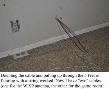

For starters, here is the cat5 cable as I bring it UP from a crawl space five feet above into the wall of a home office (there must be a better way to bring the cable up through the walls):

It was my mistake not to refer to this picture:
In that picture, it shows I did exactly (almost) what you suggested.
What I did was drill the hole in the wall down the five feet to the crawl space below - and THEN I pulled the wires through. Only after that, did I cut the opening for the wall plate as shown in the picture above.
Had I cut the opening first, I would have seen that there was an electrical wire dangerously close to where I had drilled!
Since that electrical wire went rigidly into a stud exactly where I had cut, had I moved the drill just an inch further up on the wall, I would have drilled right through the electrical wire!
Even as it is, with my close miss, I wonder if the cat5e cable is too close to the electrical wire for safety?
