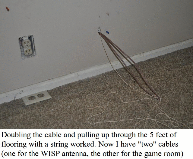

Is this how you wire the RJ45 female wall mount connectors?
I recently did my very first cat5e wiring in my life (details elsewhere).
The tools for the male connectors weren't too hard to figure out but what tools do YOU use for the female connectors?
Here, for example, is the sequence of steps for my very first connection
- but the tool I used seems like overkill for the job it's doing.
Do you have better ideas?
For starters, here is the cat5 cable as I bring it UP from a crawl space five feet above into the wall of a home office (there must be a better way to bring the cable up through the walls):

It's already done (my first attempt at wiring cat5e cable) - but I would like to learn & improve from your experience for the next set (coming soon so I can wire the upstairs bedroom).
