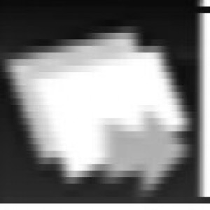

Oooops. I hit the send keystroke before I was finished. Here is the picture of my temporary 2.4Ghz setup: I get -77 dB received signal on AirOS. INSIDE: I get -92 dB received signal on AirOS. The difference is that it won't work inside; but it works fine outside (just a foot or…
OUTSIDE: I get -77 dB received signal on AirOS. INSIDE: I get -92 dB received signal on AirOS.
The difference is that it won't work inside; but it works fine outside (just a foot or two away) on the deck outside the window.
It's not the screen (as it's cloth and we tested that). It's the window (which we tested by opening it up).
Since it's cold and windy on the deck, we would like to use the antenna inside. First we have to figure out WHY we lose 15 dB through a simple window!
Can someone tell me why?

Site seems to be down at this time. Low-E has been required for new construction in California since about 2002. From your photo, the window construction looks very recent and will likely use Low-E glass.
The numbers for attenuation through various materials vary wildly depending on testing methodology. For example, if your test radio is fairly close to the window, you will get some value. However, if the window is not much larger than the antenna, and you back off some distance from the window, it starts to look like an aperature, complete with edge diffraction and Fresnel zone effects. Size matters as does angle of incidence. In your photo at:
The dish is much too close to the window frame at the top.
