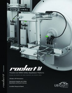

While I used to have a 2.4GHz Rocket M2, I switched to the less noisy 5GHz Rocket M5 which has vertical and horizontal channels that are set by the WISP (who logs into the antenna to set it up from afar).

Mine is a 27dBm output -94dBm sensitivity 5GHz Rocket M5,
although I have 28dBM -97dBm 2.4GHz Rocket M2s and nano bridges and even high-power bullets scattered all about the hillside.
I had a talk with Ubiquiti support over in San Jose, and they said the AirOS firmware was set that you couldn't possibly go over the 1 Watt legal limit of the 5 GHz frequency power output (which itself is ten times higher than the 2.4 GHz band legal limit), once you set the country (which is usually set to the USA because the limits are highest in the USA).
They told me that you can try, but the firmware won't let you, even though it might *report* that it's over the legal limit.
My connection is at the higher end of that 5 to 10 mile range, and my throughput is just OK. I have clear LOS with nothing in the first Fresnel zone too.

I use the Rockets mostly nowadays, where AirOS has some pretty good diagnostics (I love the noise interference waterfall display information!)
I keep to the limit. I'm pretty much *at* the legal limit though, since my AP is something along the lines of 10 miles away (or so).
I agree, even at 5GHz, noise is *everywhere*, so, I need a good dozen decibels above the noise to connect.

Wow. To me, a "dish" is a Rocket M5! Yours are far larger than mine!

Mine can go about 10 miles reliably, but it's only about 18 inches or so in diameter.
