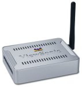

I'm trying to get a wireless bridge working (a viewsonic WAPBR-100) and its instructions state I need a static IP address. My router is a DLINK DGL-4300.
Following the instruction that came with the wireless bridge and changing the IP address of the network card in my computer where the router is attached to causes me to loose my internet connection. Am I also supposed to change settings in my router.
Searching the net for help I found some instructions (see below) that request I do a "ipconfig/all" command and copy those values in the TCP/IP settings for the network card. The only problem is that examples I find show one set of values in the DOS window and a different set a values in the "static IP config section" with no explanations why the values are different. Then do I have to go into the router and change more settings??
I am totally confused. Is there any good site explaining how to do this. I looked at dozens and all seem very confusing.
Thanks, Martin

Well after all that info and 5 hours of trial and error and finally a call to Viewsonic got it working. Apparently there is a bug in the software and they told me initially I could not use WPA security when configured as an AP client. Then Viewsonic called back with a workaround instructing me to manually put in the MAC address of my router rather than selecting it after searching for networks.
Would not work with WPA TKIP no matter what I did but did work with WPA AES.
Thanks for all the help, I learned a lot today.

However, the Viewsonic WAPBR-100 appears to be a repeater and not a bridge. Digging...
, it does both repeater or game adapter. Seems kinda strange that it doesn't have a DHCP client.

Viewsonic wants the serial number in order for me to download the user guide so I can't walk you through the instructions. So, I'll *GUESS* which means that the following probably has some errors. If you call Viewsonic support, be sure to tell them that I think they're idiots.
  1. You need to get your computer to talk to the Viewsonic bridge. The Viewsonic will arrive with a default IP address pre-configured. For example, I'll guess that it arrives at 192.168.1.2. Note that the
3rd octet is different.
Temporarily configure your computah to a static IP address of: IP = 192.168.1.55 Netmask = 255.255.255.0 Gateway = blank DNS1 = blank DNS2 = blank
  1. You should now be able to point your web browser to the Viewsonic WAPBR-100 at: http://192.168.1.2 and get to the configuration. Do the wireless setup and make sure you can "see" the DLink.
  1. Change the IP address of the Viewsonic to 192.168.0.2. When you save the configuration, you will lose connection to the Viewsonic. Don't worry about this now.
  2. Now, change the IP address of the computer to: IP = 192.168.0.55 Netmask = 255.255.255.0 Gateway = 192.168.0.1 DNS1 = 192.168.0.1 DNS2 = blank This is strictly for testing. You should be able to browse the internet normally. If not, then connect to: http://192.168.0.2 and fix the Viewsonic configuation in accordance to the instructions that I can't download from their moronic web pile.
  1. Once you have it working, you can leave the computer at a static IP or put the computer's network address back to where it was before. That means IP address, Netmask, and DNS assigned by ISP, and Gateway blank. This is the default configuration where the IP address will be assigned by DLinks router. The reason for the static IP address in step 4 was because if the wireless was NOT working, you would not get a DHCP assigned IP address to the computah.
