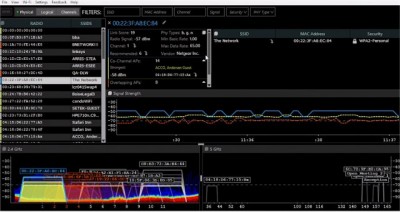

Another thing to try Fred would be one of those freeware wireless signal testing programs, like Vistumbler found at:
or inSSIDer 3 which can be found at:
One note about inSSIDer, they went commercial after the above freeware release. inSSIDer 4 is only available as a paid or demo version.
Anyway try one or both of the above and see if someone else has setup a router or access point on the same or adjacent radio channel and is interfering with your signal.

Using either of the RF sniffing programs already mentioned you can take a laptop and power off your known radio stuff and see if others are on the same channel. Then power your stuff on and check the signal level on a laptop and see how "loud" the transmitter is broadcasting the SSID you are looking for compared to the other signals (if any). At the same time you can see how far away you can still get a valid signal.
I have been in large apartment complexes where there were 5 or 6 devices found on practically every channel. Took a bit of tweaking to get things working right there. Funny thing was that some of the apartments had unsecured connections that were quite a bit faster than the slow DSL I was paying for.
If all else fails, take the Airport and a laptop to another physical location and see how the signals look on the SSID checking programs. Reason I mention that is there are RF signals that can jam an access point but are not visible (understandable) by receivers. They sense the interference but have no idea what is actually causing it. Trying another location can help pinpoint if that is the problem.
