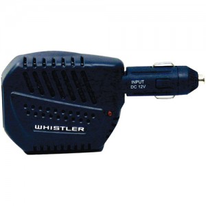

3 quick thoughts.... I had a sort of similar problem, and got a few of those power/lamp timer things (a few bucks each), and just have it/them set to turn the power on/off a few times a day. At my sisters place we use POE and just have the main power for all the AP's cycle off and back on a few times a day... A friend of mine has those gel battery boosters (about $30 at walmart) and a cig lighter inverter ($10, plugged into the dc outlet on it) to power his linksys', so the AP power wart always has continuous/clean power from the battery/inverter, and the recharger for the battery pack is plugged into the not so clean/reliable wall power...

While interference does cause some problems, I've found dirty power causes way more problems with AP's (specially in the cheap multi office buildings they make nowadays), and even short enuf power gliches to lock up anything powered by wall warts, but not mess up clocks/tv's/etc.
That was the basic idea behind using an auto booster with gell battery/inverter/charger etc (basically a poor mans UPS, about $49 see the one at walmart
and this $19 cig lighter inverter
) If nothing else, try it on one, just to see if that fixes it or not, if so, then you can try other/cheaper solutions, and if not, at least you have some handy things for your next road/camping trip.
