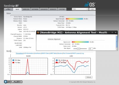

This works: laptop wlan0 --> open guest SSID of router This fails: laptop eth0 --> Nanobridge radio --> guest SSID of router
Q: What DNS/Gateway/DHCP settings on a linux laptop are needed to connect to a home broadband router via a Nanobridge M2 radio?

I can only 'associate' with the router SSID (see screenshot here):
DHCP, the gateway, and DNS appear to not work for some reason.

It's difficult to answer with knowing the topology of the Nanobridge. The name suggests that it bridges everything together, in which case you would be transparently connected to your home broadband router. However it doesn't sound like it is bridged if you can't see your home router network through it.
Actually I've just looked at your screenshot and it says "Network mode: router" which explains why it isn't working how you think it should be working.
This Nanobridge M2 is an 18dBi parabolic antenna & a 200mW (I think) transceiver which I previously used to connect to a WISP.
Connected to the WISP, it was set up in router mode (to protect the WISP's network), so I figured it should be in router mode when connected to my home broadband router.
But, if it needs to be set up in bridge mode, that's OK too. The only problem I have is that I 'think' it 'should' work in router mode also.
Maybe not. Maybe that's the problem.
In router mode it easily associates with my broadband router SSID - but it doesn't get on the net.
So I guess the first advice is the generic simple question:
QUESTION: Q: What is the recommended way to set up this radio?
I understand I need to set the radio as a "Bridge" because:
- The bridge makes everything one network
- The bridge uses the upstream dhcp server & dns server
- The bridge sends all packets through
Setting the radio as a router separates networks & requires its own configuration of dhcp server/dns servers, which didn't work for me.
I think both use the same gateway setting, so now I have to figure out how to set up the laptop to talk to the bridge.
Station WDS for a transparent bridge.
