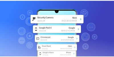

How does my Android phone figure out what's on my network without logging into the home router?
I can see 8 devices on the network when I log into the admin account of the router using a web browser on a laptop.
However, I can see all those devices from my Android phone WITHOUT logging into the router, simply by using "Fing" Android freeware:
My question?
How does the phone see both wired & wireless devices (such as a wired printer & a wired Ooma) without logging into the router?
More importantly, how can I get Windows & Linux to see the same 8 or 9 devices on my network that the phone sees *without* logging into the router's admin account?

This is wrong. Fing will show you EVERYTHING on your network (past and present), without any need to be root!
Try it to see what I mean and post a screenshot. Fing - Network Tools, by Overlook

The router (as admin) is accurate. The (unrooted) iPad (with Fing) is accurate. The (unrooted) Android (with Fing) is accurate.
Yet, the (root) arp-cache on Linux is missing all my iPads!
The question is what Linux program (or Windows) can list *all* the devices on the network?
Here is another result from Fing on unrooted Android:
Here is the comparable result from netdiscover on Linux:
