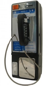

What is a WECo 1C2 payphone?
I am familiar with the single-slot 1A2, but that was back in the 1980s. Is the 1C2 an upgrade? Do you have a link to a picture?
I suspect you didn't really mean to imply the movie theater also had a second 1C2 in the box office.
It's the current standard single-slot touch-tone type that you would typically see in a phone booth or enclosure. A 1C1 is the rotary version, and a 2C[12] is the panel-mount version. I have not seen a rotary model in service since the early 1990s.
Here is a picture (this one is missing the locks):
Most of the current ones now have a volume adjustment button in the upper-left corner where the "STOP" placard is located in the picture. The newer ones have an electronic (as opposed to mechanical) coin return mechanism and may have more electronics inside.
Actually, I did. They have two of them, both on the same circuit, one in the lobby and one in the boxoffice. I have never seen this before or since. The building dates from the 1920s, but the phones are obviously from the 1970s/1980s or later. This is in Verizon territory in Rhode Island.
