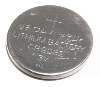

Lithium batteries are rechargable
No, lithium batteries are the ones used in motherboards and the ones that come with 5800 series wireless for example. *Lithium-ion* batteries ARE rechargeable, they are used in cell phones, laptops, etc..
Two different batts.
