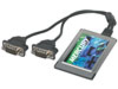

Ok.. we had a conversation on here the other day about the fact that most new laptops don't have serial ports. There are USB serial adaptors (I have one) but I hear they don't work with all software. I currently use a couple old Toshiba laptops I got from usedlaptops.com several years ago that do have serial ports, but I got to thinking about options.
Somebody mentioned that there are PCMCIA to serial cards so I checked one of my vendors and found this one.
Looks like just the ticket except its relatively expensive at $205.00
Any others out there that might be a little more economical and work well. I would really like to start using newer laptops for stuff so that I can integrate better laptops with more services in the field.

Bob check Ebay. I got a good deal on 1 there for far less than $205.00, also shop around for a Single RS232 rather than that double. Look around for Socket I/O they are more reasonable.
Bob....
$85
Also sewelldirect.com carries a whole bunch of them.
You might check with the people at the below site. They make some USB to serial equipment which works very well. It has been my experience that they are very responsive to questions. They may have single USB serial adapter that will work with the desired equipment. If the programming software is old and requires hardware bit banging of the DTR/RTS lines and such, then the PCMCIA card may be the only way to go.
