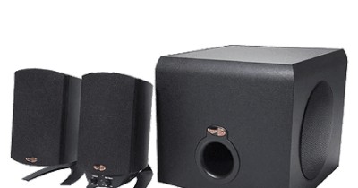

To clarify things, do your Klipsch speakers resemble these...
or these...
I think Mitch assumed the former while you meant the latter.

Dave, You are absolutely correct regarding my explanation of what I wanted to do. I should have been more specific in my request. I have the Klipsch 2.1 computer desktop speakers. As both of you have explained, I do want to go from receiver(source), to PC soundcard then out to the speakers. So, based on the information you have given me, tape-out to line-in on sound card is the way I will try first. Please watch for my post tomorrow and I will let you know the results. Dave and Mitch, thanks greatly for your response, patience and detailed explanation on what I need to do. Dave, you are right again. Without guys like the two of you I would probably have to watch TV or stick to my portable CD player. Regards, Tony

Klipsch computer speakers are not quite the famous corner horns. I've always lusted after some Klipsch horns, but need a new house to properly house them.
