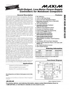

ok, never mind my ignorance - last time I played with power supplies they were still all transformer based. I put google to work and couldn't find any mass production DC/DC converters with dual outputs, but I did find a component that seems perfect for this application; the Max1630-Max1635 power supply controllers for notebook computers.
If you can read a datasheet and use a soldering tool, you can build your own dual output 3.3V/5V DC/DC converter with this:
Should work very nicely with a 12V battery and will give you safe and stable output. Use the schematics on page 8 and pick components for a load current of 3A on page 9.
hope this helps. Peter
