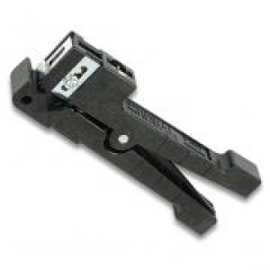

Ideal makes a Cat-5 stripper that runs about $15 or so. I have a Greenlee combo RG-6 and Cat-5 stripper that works, but I usually end up just using the Ideal. Carl Navarro

What do you guys think? I am getting sick of the pocket knife approach, and none of the many wire strippers I have in my arsenal (including a phone cord making tool) do the job properly with the twisted pair.

I use Paladin Tools AM12 stripper about halfway down this page.
I've have the ideal stripper as well but prefer the Paladin.

Is this the one? (Halfway down the page)
Yes, but look in the big box home improvement stores. Ideal's specific part number 45-165. Mine came in a kit with scissors, a punch down tool and something else for about $90, and the tool alone must be about $20.

I use a little plastic spinning tool with a very shallow razor blade in the jaws to score the jacket. Then pull.
-- Robert
Yep. You want to adjust the blade to not cut through, but to score deeply enough that a gentle bend or pull at the score will "break off" the jacket.

Ya, you can purchase a simliar stripper from Home Depot for ~20.00 or less.
I've been using that one for quite awhile. I just bought one at Graybar for ~17 bux.

Does this strip the inside pairs, or just the outer shield? I can't really tell from the description, but it seems like it's just for the outer shield.
The blades are adjustable, although you don't wan to strip anymore than just the jacket.

That Ideal stripper is a good one. Just make sure you play with the depth of the blades on a scrap piece of cable before you use it on a real one: the blades are not set to correct depth when you get it from the distributor. As a matter of fact, you'd have to fully retract the second blade as it is setup to cut almost the entire cable - something you'd expect from a coax cable stripper, which it is.
When you set the blade's depth, make sure it does not completely cut through the CAT5E/6 cable's jacket. It only needs to score the material, and you'd then finish it off by bending it a little, so the score becomes a cut. This way you can be sure the inner insulation does not get cut. You surely don't want the inner insulation disturbed in any way.
